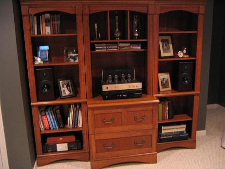

The sound is very lively, and the bass is less muddled now, even with the poor speaker placement.
For the investment involved, a listener with a good ear would guess a lot more went into this.

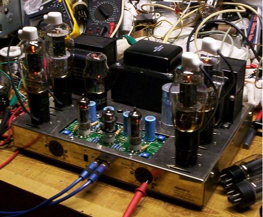

One of my long time creations is finally taking shape.
It's 6BG6G tv sweep tubes utilizing adaptors I built to fit a standard socket.
Right now it's in experimental stage but running well, I'm testing on st-70
output trannies but the final build will be Acrosound TO-300 outputs which
are a very nice impeadance match for these tubes.
These are 19watt plate tubes so they should work well with the Acro 35w OT.
I will also be experimenting with the 35watt plate versions on a 60w Edcore OT.
So far I like what I'm hearing and my front end board is holding up rather well. :-)
OH yah this 70 has the new triode electronics beefier power trannie as well.
Not needed with these tubes but I now can run kt88 and or kt90's in this amp.Upload

What final output would you expect with 88's or 90's, seeing as you have the power transmission in place?
Clean your bench, man, make room for a beer can or something.

On an original 70 the power trannie is the limiting factor without it bursting
to yeild about the 40wpc rated, on one with the new power trannie 2 things
become the limiting factor and that's the ouput trannies and the single 5ar4
rectifier to the tune of say 55wpc if your really pusing it.
The outputs the farther you push them the less bandwidth you can yield from
them, a 5ar4 rectifier is good for 250ma of current it can provide.
So you need beefier outputs and either solid state rectification, dual rectifiers
or a pair of high output tube damper diodes which you could use with this new
power trannie and remove the original can cap, install another socket and and
go dual rectifier or dual dampers. But really by then you might as well build a
new amp and do it right with more room and a better power supply.
I have a plan for the future of building a bigger amp with larger outputs and the
beefed up power supply on a larger chassis, but the 70's are about done here.

With ss rectifiers, would the load be lessened enough to make a safe gain for KT90 tubes at full stage?
Username: Kegger
Warren, MICHIGAN
Post Number: 2771
Registered: Dec-03
No you wouldn't want to try an get full KT90 operating on the ST-70's output trannie.
You'd either burn up the trannie or saturate the core so bad frequency would suffer much.
To get passed say 50-55 watts you'd want a different output trannie then an original 70.
The citation amps and some of the heathkits like the w6 have much beefier outputs you can push.
I have a CIt V I plan on doing some different type setups with utilizing it's outputs on monoblocks.

Username: Joe_c
Atlanta, GA
Post Number: 1390
Registered: Mar-05
Finally going to move the 2ch setup into the office so I can enjoy it more. Having bookcases delivered tomorrow and even though the speakers will be on the shelves (not ideal) I am very excited about actually hearing my setup while I work. Will post pics after it's all setup.
Username: Joe_c
Atlanta, GA
Post Number: 1392
Registered: Mar-05
Ahhhhh, looks good if I do say so myself. Acoustics aren't as bad as I thought they were going to be.
Username: Nuck
Post Number: 6339
Registered: Dec-04
Nice set of shelves, JC!
lookin' good!
And front and center, especially!
Username: Jan_b_vigne
Dallas, TX
Post Number: 9993
Registered: May-04
Is that the CD player you're using as an isolation platform for the amp?
Username: Nuck
Post Number: 6349
Registered: Dec-04
Somebody had to say it...glad it wasn't me!
A heat sink for the cdp...yup!
Username: Joe_c
Atlanta, GA
Post Number: 1395
Registered: Mar-05
Not ideal, but at least I use it now.
I would be better having a platform above the cd for the amp?
Username: Joe_c
Atlanta, GA
Post Number: 1396
Registered: Mar-05
Ok, you critical bas*&^ds!!
moved the cd to lower side shelf and left tubes to bachelor status. Sounds worse!!!
j/k
thank you for guidance
Dallas, TX
Post Number: 10006
Registered: May-04
Sure it sounds worse. You were using the CDP as an isolation device. Get something else under the amp besides a boxy cabinet and then listen.
Username: Joe_c
Atlanta, GA
Post Number: 1400
Registered: Mar-05
Actually Jan it sounds the same to me. The tubes and amp I have are a combination of not too high end and super low microphonics so there really isn't that much difference. Mainly moved it cause it looks better and not so worried about heating up the cd player. I would like to have the room to just lay everything on pieces of marble directly on the floor, alas I am not in a big enough house yet. I will keep saving my pennies and maybe one day I will have that perfect setup like you have.
Username: Nuck
Post Number: 6359
Registered: Dec-04
JC, don't get touchy, you posted the pic.
Very nice. Now get the platforms in place, in a nice finish, you will be oh so fine.
