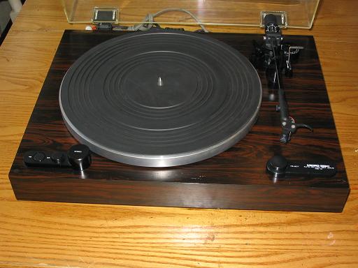

I recently picked up another table that has a grado cartridge that I was trying
to figure which cartridge it is "all it says is grado with JG in the front, all black"
and when I did a google search found many people complaining of the hum with a
grado cartridge and an unshielded motor.
Even found this on review sites where they have changed the cartridge and it's gone away.
From what they say it's a known issue that a lot of people have with non shielded motors.
Some have gone to the extent of taking there tables apart to shield the
motor and fix the problem. So it sounds real to me. They even say it's not on
every table and if you have a new table to take it back and try another table.
Anyways so far my impressions of the grado cartridge is kinda like an older
tube amp comparred to a newer one. More testing needed at this point.

nothing special Jan just a Micro Seiki MB-14 Belt drive for $80, a backup!
