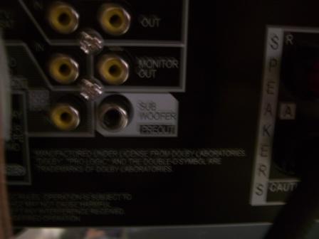

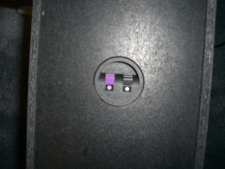

Newbie question--I have uploaded 2 pics. 1 is of my subwoofer and one is the back of my new Pioneer VSX-516-K 7.1 receiver. My problem is I am trying to connect my subwoofer, but the inputs on the back of my subwoofer only take the +/- speaker wire and the output on the back of my A/V only give you the monstercable output. After talking to several people, they suggested I buy the monstercable subwoofer cable and cut the cord, then separate the +/- wires inside the cord, and connect it. I did that and i am getting no sound from my subwoofer. Any ideas??

Stop talking to those people!!!
You have two options.
1) Buy a new subwoofer that has the correct inputs and a built in amplifier. You need a real subwoofer anyway. Where did this one come from? I assume a HTIB system. It is not a "subwoofer". It is a cheap driver in a cheap box. Buy the real thing. Line level outputs from the receiver are meant to feed an amplifier. You have no amplifier for this subwoofer. It won't make noise without an amplifier. Buy a real subwoofer or as close as you can afford. Give this "subwoofer" away, it is useless with your new receiver.
2) "the inputs on the back of my subwoofer only take the +/- speaker wire and the output on the back of my A/V only give you the monstercable output."
So, what, you bought a receiver that doesn't have speaker outputs? You can run the cables from one, only one, speaker output to these connectors on this "subwoofer". It will make noise. This will be similar to running your car on a doughnut tire without enough air pressure. It will be very unpleasant to do so and you'll wish you hadn't in short order - but it will make noise. Until you try to outsmart me and connect the outputs from both speakers thinking that will make things better.
It won't.
It will blow up your new receiver and then you'll still have to buy a real subwoofer and get your new receiver fixed.
If I were you, I'd take option #1.
