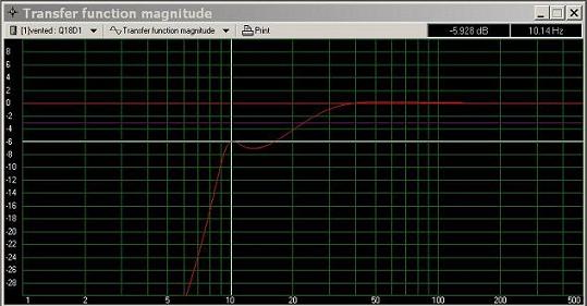

Ok. So far I've come up with this response graph (EBS).
Hope you can read it, or at least see the gist of it.
Design Goals: Deep Extension, Good SPL and SQ and much more
So far: Solid 10hz Extension, 117dB 10hz, 120dB 20hz, 123dB 30hz with 1200w+/driver.
Max SPL by Xmax limitations - 11hz 130dB 15kw/driver (WOW, RUMBLE RUMBLE haha) , 20hz 120dB 1200w/driver , 30hz 125dB 2200w/driver
When I get this done, I hope I can have an awesome movie/music experience after completion. I still have store credit to use too. I'll be DIY'ing my mains.
Note: Design subject to change

Well everyone at Avs seems to like the idea of EBS for its SQ and SPL characteristics. The box total volume will be a bit large for the woofers though (50ft³ total), but it's worth it. It's more than worth it.

when i was building my EBS (12cuft, tuned to 13hz, FI Q 15" driver) i was told to smooth out the hump that appears due to tuning. I guess that because of reflections in you're room the lower end sound with actually increase dramatically. thus with that much of a peak down there it will get really really loud at that point compared to the rest of the sound.
If i were you i would head over to AVS or http://www.hometheatershack.com/forums/diy-subwoofers/ and clear it with them. they really do know what they are doing.

Naw I've been talking to the people at AVS for quite a while now. Thanks though.
I've read up on this for quite a while now.
I made sure to keep PPO
(my own little acronym haha) resonance >190hz, EBS slope 1.5, cone excursion peak 70-80% in ultra-port range, and aaaaalllllllllllllllll those other little things (like port outlet, enclosure bracing/building technique, etc. etc. goes on and on) . Haha don't worry.
Oh yeah, mine'll be similar, but I guess I forgot to tell you it's 2 Q18D1 drivers 50ft³ 11hz tune on an EP2500 for the proposed design. I've got plenty of time before actual materials bought and construction begun.
Yes, that's definitely true. You ALREADY have the room gain in effect and when you have a peak down low along with that it's like KABOOM...your pictures have been blown off the wall or there's a local earthquake!
