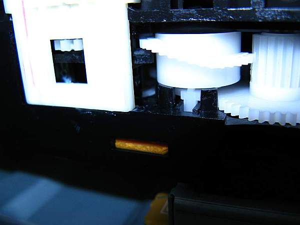

Username: Clockworkdoorbell
I've just fixed this problem on a mchine - it's very simple. Take the cover off the unit and then look at the left-hand side of the machanism (as viewed from the front of the unit). There's a tower of four cogs under a white plastic snap-on cover. The shaft they're on is supposed to go up&down to select one of the three trays, but on our mech. the funny-shaped wheel had popped off it's fork-shaped thingy. You just have to pop the white cover off & rearrange things... See photo
Username: Romane75
Registered: Nov-07
Dear Sam Moody,
I have the same problem on my PDR W739 but I can't understand exactly how to fix the problem with your last email... Could you please explain me more precisely (sorry, I am French ;))
