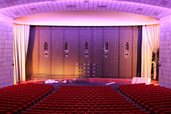

Let’s have a long story short ok.
Note the professional cinema THX set-up and how the loudspeakers are positioned into the THX baffle wall and WOW look at that cluster array of JBL 4645C in the centre bottom part of the screen and placed above it is the JBL custom array yes centre yes this is how its done now JUST DO IT!
Username: Nuck
Post Number: 7174
Registered: Dec-04
How did the picture of my basement get out here?
Username: Petergalbraith
Rimouski, Quebec
Post Number: 2021
Registered: Feb-04
Didn't picture you as a JBL kinda guy Nuck.
Username: Artk
Albany, Oregon
Post Number: 4684
Registered: Feb-05
That's actually a picture of his family van...and I thought things were bigger in Texas.
