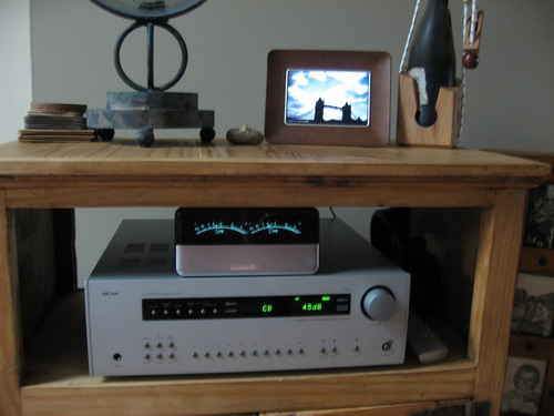

Username: Pablo
Post Number: 54
OK, now there is WOW effect!!! Arro's biamp with Arcam AVR280 are briliant! Sqeezebox conected via coax reading wav as a main source, totem tress cable, took the old sub out, Arro's in the corners toed in on claws with balls, and beaks - this is a dream set up for me and it sounds great. With bi amping and corner placing Arro's have (one would never believe!) lots of base, and my sub was not needed.
thank you all for help, I will put some pictures soon.
Pablo

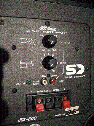

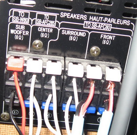

Post Number: 55
Frank, Nuck - and anybody else help!
Now we are entering diffrent ligue! In basement for my HT I have 5y old panasonic all in one HT (I know but after Arcam have to take a breake for a while)There are 5 satelite speakers and sub. I have already changed front speakers for my 4 y old bookshelf - sound dynamisc RTS-1. Already big improvement. I also have sound dynamics RTS-800 sub but how to use it? the panasonic all in one HT has speaker type sub out connection (L, R) and is marked as 6 ohms (so are other speakers) and this is how the panasonic sub is connected just 2 wires L,R. So the only way I see to use it is to run speaker wires from left and right output on panasonic HT box to Sound dynamic sub and tie the ends together with L, R front speakers. So Front speakers are connected to sub - same terminals as the speaker wire going from HT box. Or just forget it? If this works would I use both subs?, Like I said there is no more mony in the budget and I do not want to burn anything.
thanks guysUpload
Username: Nuck
Post Number: 7042
Registered: Dec-04
Pablo, the speaker outputs from the Panasonic go to both the front speakers and the sub.
ie: each post(or clip) from the panny will have 2 wires. One goes to the speaker+, one goes to the sub+.
You can also use the speaker connections for the double wiring.
All parts are made for this, no damage will occur.
Nuck
Username: Pablo
Post Number: 56
ok just to be sure from panasonic LF - 2 double cables. One goes to front left +,- speaker and other to left +, - sub input. Do I keep panasonic sub connected already to subwoofer in or take it out?
what is double wiring? the bookshelfs just have +- (not like arror's)
Username: Nuck
Post Number: 7061
Registered: Dec-04
The unit must be for Canada, as it has French and not Spanish, eh?
Remove the present sub wire.
Double the present wire connections to the front speakers, and run those 2 pair to the speaker level in on the sub.
Good photo's are helping a lot, man.

Username: Pablo
Post Number: 58
yes I live in Ottawa
so remove panasonic sub?
Username: Nuck
Post Number: 7063
Registered: Dec-04
yep, just add the new one, wired as described.

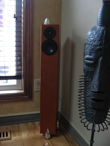

Nice setup.
I dig the big head with the Arro's.

Pablo,
I hope you're enjoying everything.
Also, that statue blends very well with the Totem theme!

Pablo,
Fabulous furniture!
Some suggestions for you:
1. I don't thik it's wise to have the squeezebox right on top of the Arcam. If it has to stay there, make sure it is not obscuring any vents if possible. Otherwise I'd put it on the lnext level above if possible.
2. Have you tried the Beak on the outside corners? That's where Vince always places the Beaks if only using one pair. (Vince recommends one pair per speaker - it makes a small but worthwhile difference - maybe Christmas present?)
3. I imagine that the bass is quite accentuated with the speaker so close to the corner. If you pull it out just 3 or 4 inches (and toe it in slightly less), you may get a more balanced result.

thanks Frank, I will try these sugestions
squeezebox can go next to Arcam but it is really small thing Dimensions: 7.6"W x 3.7"H x 3.1"D (192mm x 93mm x 80mm) including stand
pablo
