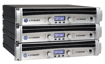

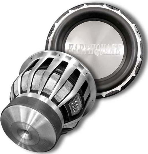

Man if you want the maximum bass possible from those things build on to them and add these in a sealed cabinet attached to the bottom of the speakers
powered by one of these on each voice coil
