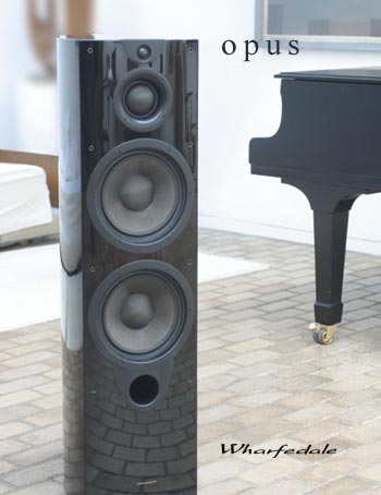

Just for those who don’t know what they look like? Hmm very nice three would be nice at the front.
Username: Nuck
Post Number: 6465
Registered: Dec-04
Thanks, Cocoon, the pic I saw had them is wood finish.Rosewood?
They look fabulous, to me.
Now THAT, folks, is piano black!
