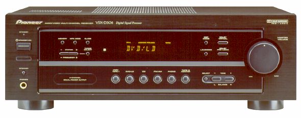

I have a Pioneer VSX-D308 receiver and what I was wondering is that is it ok to connect just a pair of speakers that are 4 ohms? This receiver is normaly for 8 ohms or higher. I attached a pic of my receiver but the color is bad mine is more black and normal color looking receiver
