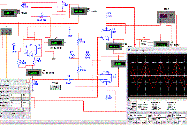

This is the rough draft of the front end. The output section is pretty straight forward, and it's the phase splitter and drivers that are most important in an amp. IMHO It's a modified Cathodyne followed by a differential amp but also has a tail like an LTP design would, kinda different then anything I've seen. Seems very very stable on sims and works well with many B+ voltages. The pic sizes here are awfully small so it may not be to easy to follow. When I take out all the meters and redo the lines it may look better,I'll post another. Driver/phase spliter is a 6J5 then the differential is a 6SN7.

The 6SN7 is shown as a pair of 6J5's (There each one half of a dual triode 6SN7) |

Oh yes don't forget the importance of the power supply as here there will be 2 one for the output section and one for the front end with plenty of chokes. |

Kegger; I'm just curious, what is the simulation software? I have not seen a valve/tube symbol for years. Since way before desktop computers. |

It's called Multisim, which isn't designed directly for tubes really but for you to model electronic circuits in general but has some tube models so you can build. I just downloaded the 45day trial version to see how it worked and I liked it. Unfortunatly it's a professional program and it's around $2000 which I aint got, so after this I will be investigating others, there is a student version which I will look into. There are many similar SPICE type programs out there that will let you do the same |

Thanks, Kegger. Yes, programs like that can be really expensive. I see Multisim is National Instruments. |
