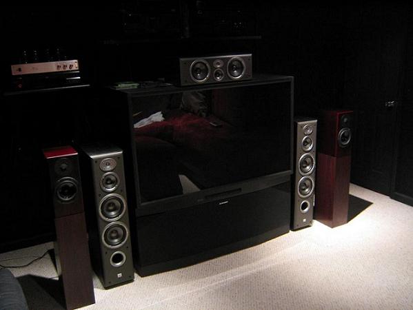

Here's mine with the custom stands in the HT room
Username: Drj
Post Number: 59
Joseph,
beauty setup. All the finishes are attractive and well crafted. I think it just depends on what fits your decor, or suits your taste, best.
Nice spot for the center channel. I have a thin plasma and so I'm not sure how I'm going to set it up. More planning required.
thanks for sharing & enjoy your system!

Username: Drj
Post Number: 60
Joseph,
your custom stands, where are they? Your Hawks appear to sit on the carpet and I assume this is why you haven't used the bearing supports? Have you tried with and without, bearing supports, and if so, does it make any difference?
John
Username: Joe_c
Atlanta, GA
Post Number: 1229
Registered: Mar-05
LOL, deceiving huh?
Those are Rainmakers on custom stands made from Laminate and mass loaded with 30lbs of sand in each. Thats why the finish looks a little different. The color is the same but the way the veneer reflects light it makes it look different.
They must look pretty good if you mistook them for Hawks!!!
Username: Drj
Post Number: 61
Oh, I see,
they're beautiful! I see now why you're so proud of them. No, I didn't notice the separation (but, to be fair, I wear tri-focals! lol). Your cabinet makers did an amazing job.
Very cool ... I'm impressed!

Joseph,
All those speakers! Are you sure you have enough?
FWIW, the proximity of the speakers is most probably having an effect on the sound. This is most usually a smearing in the time domain giving the system a slower response with less 'snap'. While your Rainmakers are playing music, go up to the speakers next to one of them and place your hand on one of the main drive units of the speaker next to the playing rainmaker. You will feel it vibrating away in sympathy. These may seem like small vibrations but they do have an effect on the sound. Try simple things like covering the fronts of the non-playing speakers with their grilles or, even better, some card or wood and see how this affects the soundstage and the timing. It's not expensive to try. Needless to say, the Rainmakers will also affect the HT system when it's in operation. However, their effect will be less and HT is less timing dependant than music. But once again, you can try damping the Rainmakers...

Username: Joe_c
Atlanta, GA
Post Number: 1236
Registered: Mar-05
Thank you for the advice Frank, I am sure they have an affect (the JBL's) on my music setup. Not too worried about HT since it's like you said, not as critical. I will try what you said about the grille's but I will not leave them because they vibrate too much with HT operation. Plus I prefer the sound of the JBL's without grilles. The one thing I would love to do is move this music setup into my office, but I have to build another bookcase first. Needs to match the cherry thats in there now since they will be sold with the house when we move. Anyway for now since it's not the highest end setup out there by any means, I will probably deal with this. I did move them away further than I had them after reading an article Jan put up about soundstage. I am sure the further away they are from each other the better. The stands definitely are not vibrating at all with all that sand and how they are constructed, but thanks again for the comments and yes that maybe enough speakers......for that room.
