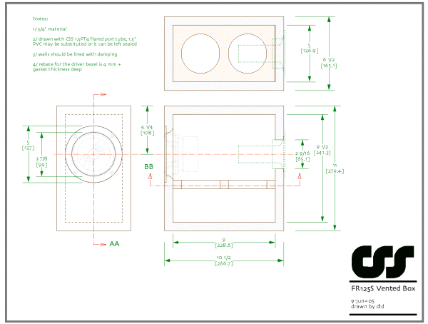

Nick,
Do you have the ability to perform any kind of minor woodworking?
If so, I recently assisted someone in building a pair of speakers that would be right up your alley.
A pair of these for $83
http://www.partsexpress.com/pe/pshowdetl.cfm?&PartNumber=302-700&DID=7
A pair of these for $70
http://www.creativesound.ca/details.php?model=FR125S
Two of these for $1.80
http://www.partsexpress.com/pe/showdetl.cfm?&Partnumber=260-402
Two of these for about $6.00
http://www.partsexpress.com/pe/showdetl.cfm?&Partnumber=260-302
So, for around $160 plus shipping and a little bit of your time you could have a nice pair of speakers. If you want to do a 6.1 system just build 2 more pair and add a sub.
You could do a lot worse for the price.

Nick,
The only woodwork is cutting the holes for the drivers, port tubes and terminal cups. Relatively easy with hole saws and a drill.
They are video shielded and sound wonderful.
If you use a sub with them you can get very reasonable volume levels as well.

Thanks for the link Christopher, I probably wouldn't do very good adding the veneer though.
A couple more questions if you guys dont mind:
Where on the dayton cabinet should the woofer and tube be put and how far apart?
What kind of wire and soldering stuff do I need?
Do I need a center channel if i want a 5.1 setup?
Thanks guys.

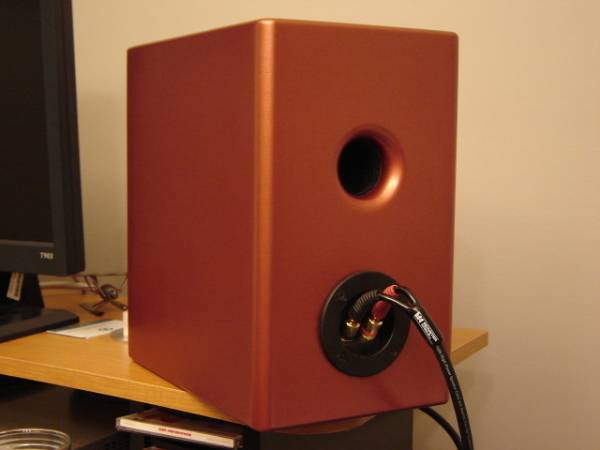

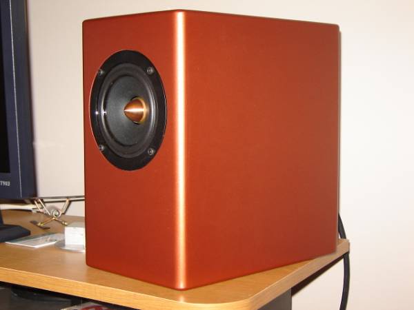

Username: Exerciseguy
Brooklyn, NY
Post Number: 727
Registered: Oct-04
With a coat of copper paint those MDF cabinets can look like these
Username: Nickrh
Post Number: 11
wow those look great, Unfortunatly im not good at painting either though and would have no place to do it in cold michigan weather :-(

I made an error on my parts list. The drivers are $70 each, not per pair.
Creative Sound has a "kit" they sell that has all the parts you would need for a pair except the cabinets for $140. Hard to beat that.
Comparing the Fostex to the CSS; they are distinctly different sounding drivers. The CSS drivers are "laid back" and the Fostex are "forward" for lack of better terminology.
The FR125S is a "full range" speaker not a woofer. There is no tweeter because it's not needed. This driver will play to 20kHz although it's just a bit down (-3db) at that point.
If you decide to go this route shoot me an email and I'll help you with the details.

A pair of Pre-built CSS FR125S PAWO speakers for $400C (Says Candians shipping, but money talks).
http://www.creativesound.ca/specials.html
Username: Nickrh
Post Number: 15
That would be a pretty good deal if they were black. Are those speakers in the pic you posted yours Chris? If so how much did that cost for the cabinets if you don't mind me asking? I think im going to go threw Stein but it would depend on if he can do the finishing for me but he sells a cabinet on his site that is finished with veneer so maybe that wouldn't be a problem. I sent him an email so we'll see.
Brooklyn, NY
Post Number: 730
Registered: Oct-04
Neither pair are mine. I downloaded these pics from SDFR boards. I've wanteed to build a pair of FR125S, even bought a pair, but I never got around to it. Stein gave me a quote of $99 for these plans in raw MDF.
