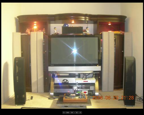

I will join the ranks of having Acoustic Treatments.
5 of my 6 panels are in this shot.

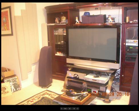

I see where you have to click on the link "Jump to this page" to actually see the panels in the pic I uploaded. In addition to the panels, there a rug, a big fat leather sleeper sofa, and a room that opens to other rooms.
It didn't have to be like this but the W.A.F. called for the stereo to join the HT system as she did not want to see speakers everywhere she looked. This is my bastardized idea of compromise. The HT speakers are hidden in the entertainment center only to come out if someone insists on listening to the HT system.

Michael - I think you're wasting some money with the number and placement of your traps. I don't know what your speakers do as far as dispersion, but do you really have a direct signal that far behind the speakers that you need the four wall mounted panels? Consider where the reflection is going if the speaker does put signal energy at that point on the wall. Any driver with that much dispersion is doing it to gain some openess and air to the sound quality. You really should only need to damp the first reflection point facing your listening position. If that doesn't provide sufficient quieting of the signal, then you damp the second reflection point. Your panels might do a better job as damping and dispersion on the back wall behind your listening position. If you pull the speakers forward a bit, there probably isn't going to be a first reflection point from the speaker shown. Please don't take this wrong; but have you done a speaker set up with any particular method in mind?

Michael,
Way to go!! It looks lie you are well on your way. Good Job!
I also have a couple of suggestions that should make an impact. From what I can see in the picture, these are things I would do if that was my room.
I would also hang a panel on the wall or in that large space behind your center channel speaker. It should make a noticable impact on dialog clarity. (it will be especially noticable during loud segments in movies when all heck is breaking loose)
I would also get a couple 2x4 by 4" thick movable panels that I would place in front of your ET center during movies. Since it looks like the ET center is wedged in pretty tight between the walls, I would place one in each corner IN FRONT of the ET center. Simply set them on the floor and place them diagonally in the corners(think airgap) so they will also be somewhat behind your towers. When the movie is over, I'd pick them up and stick them in a closet. Since the room opens up to the left, it looks like you did what you could there, so nice job. If at all possible, you'll want to try to do what you can with that first reflection on the right sidewall too. That may be difficult, because im guessing you have windows there. If you have a place for 2'x4'x4" corner mounted panels in the back, I would also do that depending on the room depth.
For those with wife issues, there is no rule that states panels need to be permantly affixed to the walls to work. With a little creativity, even those with spousal concerns can enjoy good sound too. When you're ready for a little hardcore listening session, simply bring them out, and put them away when you're finished. Since they wont be attached to anything, it will take you all of a few seconds to pick them up, and stow them away after a night of incredible audio enjoyment.

I actually took a little of a few methods, relying mostly on a Chesky disk for accuracy.
1, I started with having my right speaker up against the Entertainment Center and started moving it out using a Tool CD for bass. Once I found 3 sweet spots I marked all 3 and positioned the speaker on the middle mark.
2. I then pulled the left speaker out equidistant from the wall as was the right speaker and pulled it forward pushed it back until I thought I had a center spot using the Chesky disk.
3. I messed with the distance from the nearest side wall for each speaker to work out my rt / ctr, rt, off stage rt, lt / ctr, lt, off stage lt. This was maddening as the un-refurbished Carver did not image properly (which I did not know throughout this exercise). This also was affected by how clean or lost my soundstage sounded depending on position.
4. I towed in and out both speakers trying to bring sharpness to the center spot.
5. I tilted up and down to try and aim the tweeters at my ears.
I actually had to do this multiple times often ending at positions and angles completely unrelated to one another. The multiple panels ended up on the left wall because I did not now that un-refurbished Carver could not image left of center for me and those panels with the speaker position I had resulted in the queen of the pigs in soundstage for me.
When I put the swapped in the refurbished Carver and ran the Chesky disk I suddenly had a right off-stage and a left off-stage which was not there before and the lt ctr and lt speaker were distinct and dead on as was ctr, rt ctr, and rt. I think I might have moved the angle of the speakers by less than 5 degrees to redial in a very sharp tall soundstage.
Since the results were so on, I did not think I should mess with anything else so the panels stayed on the wall. There are no panels on the right wall as one foot past the front of the speaker it opens up at about 40” high into my Galley kitchen. There is an eat at counter from the floor up to 40”. Yes, I put my HT and audio system in the dining room as it opens up to the living room eliminating any issues with rear wall reflections and giving me the most airy space. Oh, yes I also moved my sleeper sofa up and back countless times to where I felt I was the best listening position.
This is the most work I ever had to do with optimizing my speaker placement so if I erred in some way I would be none too surprised. Any comments or feedback is certainly wecome.
The only panels behind the speaker is the one you see standing up against the left edge of the Entertainment Center (EC) and the wall. It is blocking a 4” gap between the unit and the wall as the top and bottom moldings do of the unit do not allow for me to abut the wall with the unit. The one panel you do not see is doing the same on the right side for the right speaker. The 4 panels mounted to the wall begin about even with the back of the speaker and move forward along the wall to discourage diffusion of the corner.
I will consider moving the speakers forward as you suggest, but that means starting all over with step 1 above. I expect it would be much easier with an accurate amp this time around. The only other thing I had to do with the Gallos was to determine whether the bass should fire in or out. I chose out as in seemed to heavy. Moving away from the EC will also require that I reroute the speaker cable from behind the EC to in front of it. I picked up less RF interference with the wires routed behind the EC. I may also have to move the sofa in and back when I am listening as moving it back any further trespasses on the aisle leading from the kitchen area to the bedroom area. It’s a virtual aisle but I am sure my wife will not want the couch sticking back that far permanently.

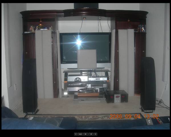

Rush (and other willing participants)
I am going to move the center channel down to a space in front of the base of the TV so I do not know if paneling the wall at the opening behind the shelf will still be of importance.
When you say 2x4 by 4” panels I take it you mean 24” X 48” X 4”?
My speakers do not have rear firing ports so is this as important? If yes, then while this will certainly take care of the reflectiveness of the wood Entertainment Center, the glass paneled doors extend up to about 60”.
As I noted to Jan in my previous post I have 2 panels covering the gaps between my EC and wall. They should stay or go?

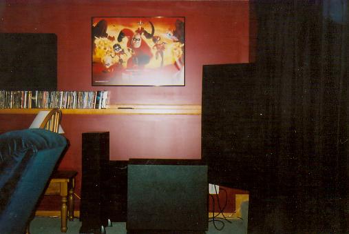

I'm not at home to attach photos, but I mimic'ed the room displayed here:
http://www.bobgolds.com/TrapChristianG/home.htm
I'm lucky that I have a dedicated rec room for gear. I'm unlucky that it was a sound hole prior to treatment. I'm lucky that my wife gave me the whole room for kit and let me put floor to ceiling corner traps. I'm unlucky that she gets the entire rest of the home (or is that the way it always goes???)
Anyway, my bass traps cost me $150 to build and are finished as nicely as the ones in the pics. There is no component in the world that could improve the sound like those traps did. Prior to treatment I was sad that we moved to a new house, and that I'd volunteered to set up in the basement. Post treatment, I heard depth and detail in the bass that I had never heard before, using the same gear I'd owned for 10 years and had used in 6 different apartments/houses. Each of those 6 places had their own unique problems, but I wish I'd known how big a difference I could have made back then. 10 lost years, really.
I have lots more to add, for those who want to listen.

Nice bass traps. I read in other forum the use of Corning 703 rigid fiber glass, did you look into those or you did not bother?
On the side wall, you have some panels, are they stuffed full of pink insulation too?
I am looking into building bass traps but have some problem sourcing 703 locally (didn't want to pay $25 shipping charge) so am wondering if pink insulation would do just as well.

Michael,
I am talking about 2'x4'x4"thick. Yes, I would put one panel each IN FRONT of your ECenter and place them in the corners behind your towers. When the movie ends, I'd stow them away.
I'd also keep your center speaker where it above your screen, and hang a panel directly in the space shown behind and above the speaker. Placing those three panels alone will make a significant difference. You just wait and see:-)

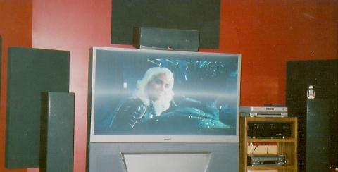

This is how my front is arranged to give you a reference. Pretty simple stuff really. One in each corner, and one on the front wall. I'll probably move the center panel over and add another because my front wall could use a little more.
This is how my subwoofer corner is situated. I have two panels acting as bass traps in my sub corner. One is laying on the floor along the wall, and the other you can see hanging in the corner. You can also glimpse one of the two GIK 244s that I have haning on the right sidewall. At least from these two photos, you can see how I have some of my treatments situated. In all, I currently have 10, and I plan to add a couple more in the future. Every one of mine are of the 4" thick variety.
Geoff,
I couldnt have said it better myself. If people really knew and could comprehend how much better their soundsystem will perform in a finely tuned room, they'd be lining up for miles to fix their broken rooms. Fixing my room made the single largest impact of any single upgrade I have ever made. Since I'm lazy and not into the DIY scene, I bought mine from GIK because I didnt want to build my own. All I did was hang them up. LOL
In all, the 10 panels cost less than $800, and it was the best $800 I have ever spent by a long shot. And that's a fact!

I suspect that with the imaging problems of the unrefurbished Carver the panels on the left wall helped some. I also suspect that I put too much emphasis on the results I got using the David Chesky CD. When I removed the panels and before I placed them where they are now, I did a Chesky CD for listening and nothing changed between the panels being on the left wall and no panels being on the wall.
OK, since I ripped the Acoustic Tiles from the left wall (just kidding they were only tacked up) and after the above test I placed the 6" wide panels in each corner behind the speaker, and the four 4" panels were paired up 2 each in front of each ECenter door covering the middle fo the glass all the way up.
Then I moved the speakers up about 15" & 18" L & R. Dialed in the base. To find the correct center rt ctr, rt, off stage rt, lt ctr, lt, off stage lt, in placement testing I had to move them about 10" further apart. Finally I toed them about 3 degrees on the left and 6 degrees on the right for a sharper soundstage. I left the black tape on the floor where the speakers had stood before all of this rearrangement of everything.
I used the Tool CD again to verify bass placement and the David Chesky CD for all other tests. All but the last listening tests are done on CD as the Apollo is still my most familiar point of reference.
The first reference was Madeleine Peyroux. The drummer moved from lt ctr to ctr????
The brushes were more evident, almost thicker in a sense. My initial impression was a tighter image.
Second reference Diana Krall, somebody moved her percussionist from lt ctr to ctr too???
I get the impression that she had her piano tuned since the last time I heard her, and now she is behind it instead of sitting on top of it as I used to hear her. The bass is back a bit too.
Why do I think that there is voodoo or something involved here? Move these cloth and cardboard rectangles around and you can re-arrange the band you listen to????

The problem remains the rather large obsruction sitting between your speakers. From what you said earlier, there was litle need for the side wall panels as they probably weren't tamimg any reflections which managed to make their way to your ears with any significant intensity. Did you just guess at their placement initially or did you actually use something to determine where the first reflection point happens? A mirror perhaps?
Treating the front wall with large® traps in the corners and smaller traps along the wall is common procedure. In this method of room treatment the traps wall traps are typically placed toward the center of the wall but that is a starting point only. Experimentation and a keen ear give the best results. Depending on the bass extension of your system, a 16" trap filling the front corners is not excessive.
However, the large reflective surfaces sitting between the speakers would be my most important focus of attention. If you are hearing better sound when you treat the wall behind the speakers, imagine what you can hear when you virtually eliminate the "stuff" between the speakers. A clean stereo image relies upon all signals reaching your ears with a degree of symmetry. If signal reflections cause the signals common to both speakers, which create the center image, to be diffused and scattered about the room, you can still improve further what you are hearing.
It looks as if you have glass doors on your wall unit. If that's the case, you probably require some dampening panels to calm the reflections from that area. Keep in mind, wall units are not necessarily bad things. If they are fairly open and stuffed with irregularly shaped objects or semi-soft surfaces (books/magazines/LP's) placed to form other than a solid wall, you can use "natural" objects to treat a corner or wall. The attempt at that point is to work with diffusuion rather than absorption.
The majority of what you do to a room will involve either direct absorption, controlled reflection or scattered diffusion. Beyond those three methods you get into Hemholtz resonators and so forth, which are typically beyond the home builder's knowledge and skills.
Try placing traps just on the inside corners of your speakers. Your efforts should be to create a wide, soft baffle between the two speakers beginning at the inside edge of each speaker cabinet. Play around with the number and placement required to minimize the effects of the center obstructions. Also, from the picture's perspective, it would appear your front speakers are not an equal distance from a central listening or photo-taking position. The right hand speaker looks to be more forward than the left hand speaker. Is this true or just due to the lighting in the picture?

If I might ask... What's is in the large wall unit? And is any of it still accessible with panels in front of it?
The HDTV seems to be in front of it (now too big to fit in), with the audio gear on shelves beneath it.
You could try removing it altogether...

You do not want to place audio equipment in such a cabinet. Most especially a Linn turntable.

The audio / video stand between my speakers supports the HDTV. Before the TV and the stand I had my audio equipment on the floor sitting on Black Diamond pucks/cones combinations, and below that were shelves from my audiophile equipment stand. Prior to my getting my tube pre-amp all my gear was inside the left tower of the Entertainment Center (EC). I had the gear on the stand at one time by W.A.F. wanted anything with speakers attached centrally located. Jan, none of my audio gear will be going back into the cabinet.
The reason I have the HDTV and stand in front of the EC is that I am afraid of the EC’s lower shelf falling on it either during replacement once I moved the TV back there or just on its own at a time of its choosing. It has fallen before with the slightest of contact.
Since goal #1 here is optimal sound quality I will set out about the following;
Remove the lower shelf from the EC. Perhaps at a later time I could drill holes up higher in the side towers and use screws to attach the clips to both towers and under the shelf.
Move the Side towers about ½” each towards the wall and empty the audio stand (I have purchased a bottle of Pro Gold and have not used it yet due to the time required to disconnect and reconnect all of my RCAs and spades. This would give me the opportunity to take care of this now too.). Next move the stand further back into the EC between the towers. I will have to figure out what to do with my Monster AVS 2000 Voltage Regulator as it currently is positioned behind the stand near the back wall.
There is a rack attached to the stand which I could hang my HDTV on thus providing me an additional shelf for spacing out my gear. That may provide me options as to a new set up. I had not used the rack before as my initial intent was to move the audio stand back under the bottom shelf and the rack made the HDTV too high, but I chickened out due to my fear of falling shelves.
If I am successful at this, why I wouldn’t be I don’t know, but there appears to be a lot I don’t know so anything is possible, I could perhaps use a quilt or something until I am able to purchase additional sound treatments, to hang from the center top shelf of the EC and let it drape down just low enough to block the TV leaving me access to my audio gear. The quilt would be hanging in front of the audio stand so any fibers that may shed should not land on / in the equipment.
PG - As to the panels in front of the cabinet doors, they are just leaning there so it does not restrict access to anything I need in there. The shelves in the right side house all of my video gear, AVR, DVD, Cable box, Panamax, etc. The open shelf on the top is reserved for my TT should I have to move it off of the floor. The patio block and granite slab slide under the audio stand. The left tower used to house my audio gear, but now is home to CD / DVD treatments, reference CDs, Cans, and small connectors, extra cables, wires, manuals and stuff.
Jan, the original placement of the panels was visually accomplished and at the closest point to where I had wall space and there could be a reflection. Not knowing the un-refurbished Carver could not image correctly I did numerous adaptations to the placements of the panels, including having 2 run horizontally on the right wall from the front edge of the right speaker along the wall under the counter top on the right wall. I also had the left wall corner covered with one panel on the edge of the wall facing me abutted to another panel on the corner of the wall facing the speakers. Grouping them on the left wall gave me the best results with the imaging I was getting from the amp. I have an inane ability to sight lines, probably from my Drafting classes in H.S. and hustling pool in a previous lifetime, so I do not use mirrors. (But I still use levels.)
Do you think quarter round bass traps would work better in the corners or stick with your suggestion of 16” panels angled in towards the speakers? Either answer would free up the two 6” panels which I could then have for redeployment elsewhere, but where? I am aware that I am asking for a lot of help here.

Plants and so forth offer visual appeal to a well treated room but do not themselves make for a well treated room. No ficus tree can deal with a 30' high wave front. No cactus can tame a 1/200" wave front.
"If your system is bright, how does a bass trap solve it?"
It doesn't. Traps are effective up into the highest frequencies, but their dimensions and palcement usually negate most benefits from a bass trap above the lower mid frequencies. For higher frequencies, you use acoustic panels and place them where they will do the most good. How effective your bass traps will be at taming a too bright room depends on their construction, numbers and placement.
Despite using the same methods to achieve a balanced room, low, mid and high frequencies are dealt with by the specific nature of the signal and its pressure wave front. In other words, a 20' peak to peak pressure wave does not require nor benefit from the same treatment that would be appropriate for a 1/2" pressure wave. "Bass traps" are so called due to their ability to affect long wave lengths. They do this by their physical dimensions. From front to back, the pressure wave passes through 12, 16, 24 or more inches of damping material. In a sucessful set up, the signal does this at least twice. The first time as the original signal generated by the speakers and secondly as the reflected signal bounced off the surface behind the trap. The signal's energy is converted to heat inside the trap and the signal strength is diminished before it re-enters the room.
Since low bass signals are omni-directional, no matter where you place your speakers, the major problems areas of any room remain the same when you discuss treating the room for bass irregularities. Any intersection of flat surfaces creates a "bass build up". The higher the number of intersecting surfaces, the greater the problem. Therefore, two surfaces (floor and wall) which intersect will have some problems. Three surfaces (floor/ceiling, and two walls) which intersect will have far greater problems. Parallel surfaces have more problems than slightly irregularly dimensioned surfaces. Despite what would appear as illogical, curved surfaces have more problems than flat surfaces. Vaulted and barrel ceilings almost always sound terrible. Corners, floor to ceiling, are the first areas to treat when trying to smooth bass response. If you can't treat the entire corner floor to ceiling, then at least deal with the points where three surfaces collide. Then you move to the largest, flattest surfaces within the room.
By using bass traps you are trying to sonically make the walls and corners non-existent. Therefore the effect is of allowing the speaker to see as close to an open space, or at least, as close to a non-reverberant space, as possible.
Traps placed between the speakers will minimize the cross talk you hear from the opposite side speaker. Done correctly this will give a slightly smaller sweet spot but should increase the spatial effects of the system. Done very well with the right speakers, the amount of left/right information which arrives at your ears is quite pronounced and the speakers and walls tend to disappear and open up almost as if you were using giant headphones.
Mid and high frequency problems are dealt with not by "traps" but by dampening panels. Or, by reflective panels, or, by using diffusion panels; depending on what the room and system dictate. There are few consumer oriented rooms which require more reflections when it come to bass response. So we seldom discuss reflective properties when talking about bass treatments. Diffusing a 20-30' pressure wave takes far too much space and is the sort of treatment typically reserved for performance halls and large, confined spaces such as auditoriums. However, depending on the room and the speakers, reflective and diffusion properties are ideal for mid to high frequency control in a listening room. You are trying to control the amount of reflected energy which mixes with the direct energy from your speakers. The reflected energy arrives out of synch timewise and often with comb filtering effects from the direct signal. Too much reflected energy makes the system appear bright, muddy and harsh. The result is listener fatigue.
Many bass traps actually have two sides; one which is open and the other which is reflective. Proper orientation will allow some or no amount of reflection to occur even when a 24" bass trap is used in the rear corners or along the side walls. Setting up a room for monopole, dynamic speakers is quite a different procedure than setting up for dipole/bipole panel speakers. Both set ups utilize the same type of control methods. But, the various types of speakers get their characteristic sound be relying on different amounts of direct and reflected sound and where the reflections occur with the different type of speakers is not similar.
Absorptive panels for the high frequencies work best when located at the precise reflection points of the offending frequencies. There are several ways to find where these points exist in a room but the most common involves a mirror and a friend. Placing the largest surface area at these points will bring down the level of the signal's pressure wave. Mounting the panels several inches away from the wall to force the reflected energy to pass through the material a second time makes more improvement in dampening ability than simply increasing the thickness or surface area of the panel itself. In effect you are doing both when you mount the panel away from the wall. An acoustic dampening panel is purposely constructed to "trap" the pressure wave inside the material. The panels are constructed of open cell foam which increases in density as the signal moves from the front to the back of the material. Foam rubber matress pads and other consumer oriented materials are typically the same structure throughout the material and are, therefore, less effective for the same amount of surface area and thickness. Fiberglass and other damping materials can certainly be used to tame a room's problems, but due to their more even construction and smaller relative surface area, these alternatives seldom if ever give the same results as purpose built acoustic panels. The cost of fiberglass or sponge foam is drastically less than purpose built panels, so, which you pick is a matter of finances and what the room will bear along with what it requires to sound best.
When faced with a problem such as a listening position which must be too close to the rear wall, diffusion almost always works better than absorption. Installing a diffusion panel behind the listening position will typically solve the muddiness and glare associated with this type of room problem.
While room treatments come in all sorts of sizes, shapes and colors, you must remember that most materials are simply too frequency selective to be useful at mid to high frequencies. If the weave of a material is too closed to allow midrange frequencies to pass through, the only option for the material is to reflect those frequencies back into the room. Other than lots of surface area, there is very little that calms a room's bass problems down other than purpose built devices.
You can begin to experiment with room treatments on the cheap however. Corrugated matress pads or fiberglass panels can give you an idea of how reflective your room is or can be. Any hard surface can add reflections in a room, though too "soft" is typically not a problem most modern, mid-priced homes have. There are instances, however, where some life might be needed in some overly damped rooms due to too many soft surfaces already in existence. Controlling the reflections to keep them away from an area is as important as dampening them in other areas. The floor and the ceiling typically represent the largest expanses of flat, reflective surfaces in any room. These are also the most often neglected areas of any treated room. A double thick carpet pad under your rug will make more difference to bass quality than an equal amount of money spent on corner traps. Treating the first reflection points off the ceiling is often the most overlooked treatment which most rooms require.
To experiment with cheap bass traps, you can bring home some large, empty boxes and a few Sunday newspapers. Loosely crumple the papers into the boxes and begin stacking them in the corners of the room and along the front wall. Get the stacks as high as possible and listen for an improvement. If the bass smooths out, you could use some real bass traps in your room. Diffusion is as simple as a bookcase full of books, magazines and LP's which are placed at various depths to allow the high frequencies to bounce randomly around the room. Place the bookcase at an angle in the corner of your room and you diffuse some of the bass energy which accumulates in those areas simply by breaking up the intersecting surfaces.

In Michael's pic, one solution that MIGHT help is to treat the ceiling corner above and behind the EC. Done with a very simple, matching fabric, might appease the wife too.

OK, back is screaming bl**dy murder, fingers are all chopped up, and the cable is not working on the plasma, but we have the mess sent to the back or the room where it belongs. The room looks better, especially when I remove all but 2 of the acoustic panels for WAF. All the stuff is now shoved back under / between the Entertainment Center (EC). I added 3 more Acoustic tiles. In this shot there is one each hung on the edge of the wall outside of each speaker and the square tile which deflects a portion of the sound hitting the HDTV.
Other changes were the two 8” Acoustic tiles are in off of the corners and in front of the EC’s glass door panels along with two 6” tiles. The remaining two 6” tiles are facing one another in the EC opening for the HDTV and stand. They are placed at the edge of each tower.
The Monster AVS 2000 is now on the floor to the right (as you view it) of the turntable. It had occupied the space where the TV stand now resides. It may end up in one of the cabinets if I can verify that it can be in an enclosed cabinet. My initial thoughts are it cannot which is why it is where it is now.
The speakers had to be repositioned. I switched them left and right so that the woofers now face each other. The left speaker is now even with the right speaker. The toe in has been reduced to 2 degrees for the left and about 5 degrees for the right speaker.
Bass is phenomenal, except when I sit by my deks 6 feet behind the listening area. I have gotten up and answered the door twice already today. Part from the solid bass, part from my guilty expectations of unhappy neighbors.
Sade was luxurious on the Linn and Billy Squire absolutely rocks, especially at Nuck listening levels. I have corner traps on order and that will be it.
For set up I used the usual, Tool – 10,000 days to set up the bass, David Chesky for imaging correctness, and Dead Can Dance – Into the Labryinth – 3rd track “Wind That Shakes the Barley” to get a perfect center.
I just purchased a First Impression Music CD “Super Sound” and have played it up and down. I will set this on the Reference Music Quality Music thread. This CD, played in its entirety is the only thing anyone needs to ID any weaknesses in their system and set-up. It is also the perfect CD to showing off all of your hard work at putting together you kit.
Off to audio nirvana once again. Ignorance is bliss!
