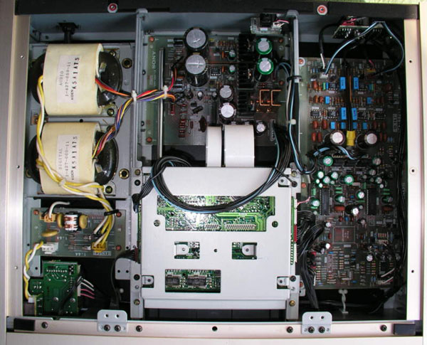

Hi here are some pics of the innards of a Sony XA-5ES in stock form taken from a Japanese web-site.
Unfortunately I dont have any pics of my modded machine. It will be on the operating table again soon, so if I remember I will try to take some pics at that time.
You can see from these pics the impeccable build of this Sony unit. I am sure the profit margins on these machines for Sony must be a lot lower than for their regular vanilla non-ES components. I am damn sure if this machine was made by a small specialist company it would have cost a heck of a lot more than it originally did.
My Sony is in similar mint condition to the one pictured..

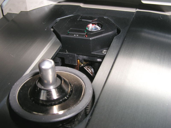

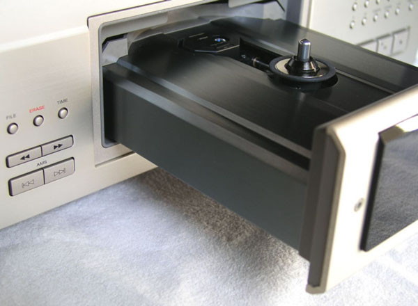

one more try......
Here is the Sony's fixed lens transport, the laser does not move, instead the CD is moved by a sled over the lens:
This picture does not show the heavy puck used to secure the CD. But all in all its a nice piece of work.
