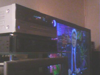

But considering you can get a power amp that will perform better into the front channels where you really only need it for much cheaper, I still think it's the best option. I've got mine sitting right underneath the receiver:

Thanks. That picture helped as i could do something similiar. Any suggestions on which power amps i could consider? I hear good things about Outlaw but unfortunately i dont live in the US/Canada.
