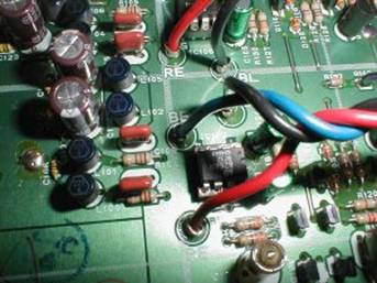

Okay when you look at the op-amp chip you normally see a semi-circular cut out in the body of the chip. See example image below:
When you install the new AD826 chips, make sure that the semi-circular cut out stays in the same orientation as the existing OPA627 chip you are replacing and all should be fine.
Here is a sample image of a AD826 installed in a Yamaha CD player, you will see that the Analogue Devices AD826 chip also has the little semi-circular cut out I mentioned. (The way the chip is oriented in this image the cut-out is on the RHS.)
Apart from that there should not be a whole lot to it.
You may want to follow anti-static procedures whilst handling the chips. Or worst case just touch something grounded like the kitchen sink, and don't wear those rubber soled shoes that always cause static shocks!!
