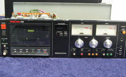

Get a Tascam 112 I'm sure you'll find them in the city and should price in the $50 range. They are built like tanks and were a part of many studios. Here is mine.
