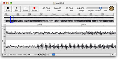

I posted this to a thread on a different board last year. It is a Mac solution. Also, while my solution is to convert vinyl to mp3s, it could also be used to burn to CDs.
I have my pre-amp's audio-out running to the audio-in card on an old G3 (RCA plugs). I play the vinyl on my tunrtable, and sample using Sound Studio by Felt Tip Software:
http://www.felttip.com/products/soundstudio/
Then I sneaker net them back to my G5 using an external hard-drive. Then I import them to iTunes. I could probably run the audio straight into my G5, but the stereo is in the living room, the G5 is in the bedroom, and the G3 is on a roller cart. This way the G3 is set-up in the living room as a dedicated vinyl burning station that I can wheel out of the way when guests come over, or whatever.
Screen Shot of Sound Studio
