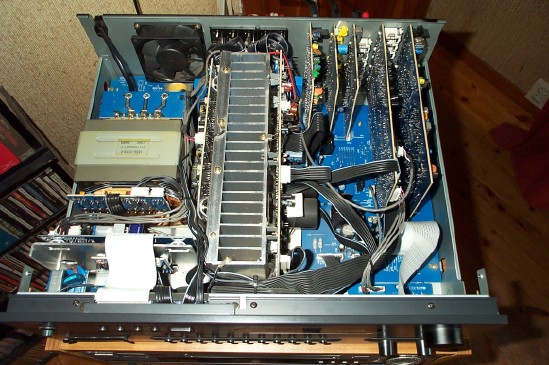

Well I just took my T760 apart again, and it definitely doesn't have a toroidal transformer. It has a huge 11cm x 10cm x 12cm laminated transformer. I couldn't find any markings on it except these numbers:
1806-3518-0
HY1050001-P
CBE 9950
OK OK I'll stop with the uninteresting excess information ;)

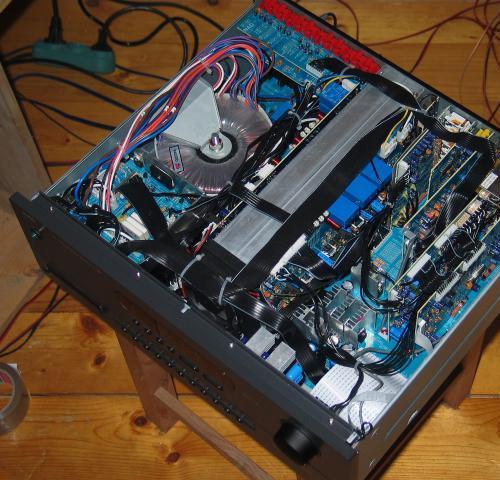

Username: Gatt767
Malta
Post Number: 37
Registered: Feb-04
Look at the massive size of the NAD T762 Toroidal Transformer!

The NAD T760 has a laminated transformer. I was quite wrong in saying it was toroidal. Apologies, Adam, Robert and others. I also find a small laminated transformer in the NAD T533 and T532 DVD-players.
Here is the T760.
NAD T760 top view

I wasn't sure myself until I had seen a picture of a laminated transformer, because the protruding copper shielded windings (not visible in picture) does make it look a bit torus-like in shape.

Nice of you to say that, but there is no way that is a torus! I am doing a grip-on-reality check. I recently took apart and Armstrong 621 and my Sony power amp. They both have toroidal transformers. I'll spare you the photos!
I also took photos of the T533 and T532 DVd-players. I included them in a post on the T533 thread to try to give a more sober review, but the browser crashed and I lost it all. I will try again later.

The CA 540R seems to be the cheapest AV-receiver with a toroidial transformer. When compared to T743 it is 6.1, but it's harder to use and loses a bit in sound quality. Perhaps it has more power and is more efficient in terms of power usage, but maybe those aren't the most importat things when selecting a receiver. What do you think?

"The CA 540R seems to be the cheapest AV-receiver with a toroidial transformer. When compared to T743 it is 6.1, but it's harder to use and loses a bit in sound quality. Perhaps it has more power and is more efficient in terms of power usage, but maybe those aren't the most importat things when selecting a receiver. What do you think?"
Well as I see it you can have plenty of power without having good sound quality, but you can't have good sound quality without enough power ;)
So yeah a powerful receiver doesn't necessarily sound good, but a powerful transformer is still important.
