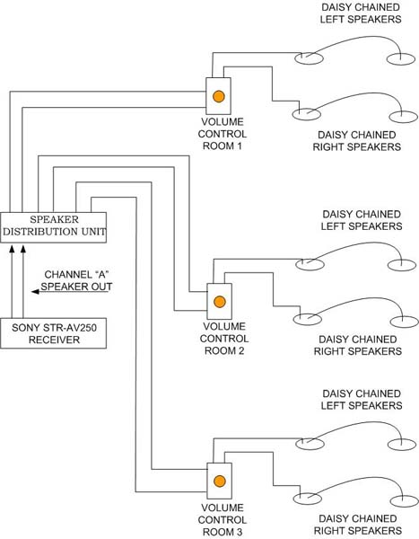

here is the layout/design

The answer NC gave you is correct. The problem is you don't know what type of distribution box or volume controls you already have. You could be spending money you don't need to spend by replacing the box or VC's with new units. Daisy chained speakers could be either parallel or series hookup. One way works well the other shuts down your receiver. Or, you might have a series-parallel hook up.
Is there a reason you don't want to have a professional look at the system? Even with a impedance matching box or VC's, you will need to know what the impedance of the hookup is before deciding how to make the new connection. Are you able to make that assessment yourself?
