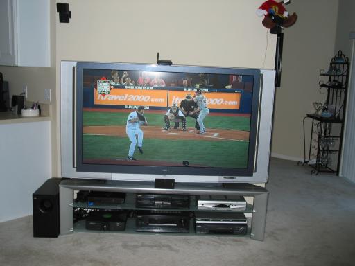

Here is a picture of my set up, as you can see I have very limited space on the side that is the reason I'd like to mount them on the wall. Do you think this would be ok?
Felix

Felix,
you can mount the Ascends as high or as low as you like, as long as you have them tilted so that the tweeters are pointed at your ear level listening position.
Personally I think that if you watch a lot of TV and movies, the 340 center channel is worth the extra money and bulk, it really puts dialogue right into your room, totally clear and natural such that you won't need to turn up the volume much to understand what the actors are saying.
If you go to the Ascend website's forum they do have a sticky on how to wall-mount the center channel too.

As you can see from my limited space I have about 7 feet across to play with. Do you all think 3 speakers (2 Ascend 170s L/R, and 1 Ascend 340 center) would be ok or to close together?
Felix

7 feet should be fine.
