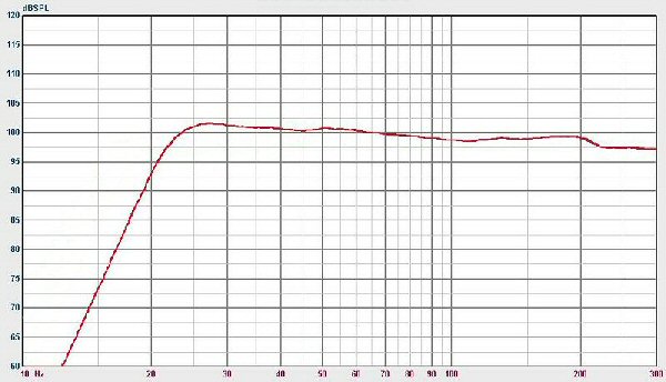

The auto-eq functions are okay until you get down to the low end of the frequency range. To tell you a little about the BFD:
Originally the BFD was designed for the performance/entertainment industry. Think about its name “feedback destroyer”. It is used in recording studios and concerts. The unit is wired into the system, set on auto-pilot, and then it searches out feedback and kills it. However, its functionality and design allows it to be used in the home theater as one of the most flexible parametric subwoofer equalizers available. With the BFD you can pick up to 24 frequencies (1 combined channel X 24 or 2 separate channels X 12), adjust the bandwidth as narrow or wide as you wish (from 1/60 of an octave to 120/60 or 2 full octaves), and either boost them as much as 16db or cut them by as much as a whopping 48db. How many parametric eq's do know of that can do that? Pretty impressive if you ask me.
As stated above, the BFD can be used as a parametric subwoofer eq. Subs are measured in either a wide open space or an anechoic chamber/room and the mic is usually placed 1 meter out from the center of the sub speaker cone. How many of us set up our sub in the perfect room and have our listening position with our ears centered 1 meter in front of the sub? When you see the frequency response of a sub measured by the manufacturer you see this: (these graphs are shrunk to comply with forum rules... click the link below them to see full size)
http://www.snapbug.ws/images/subgraph0001.jpg
The manufacturer rates the frequency response as 22hz – 200hz (+/-3db). When we place that sub in our homes there will be two things for certain and one thing for sure… if we measure the frequency response at our listening position, it will not be the same as the manufacturers response. It will look something like this:

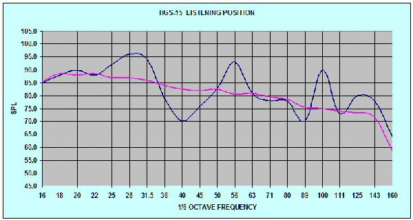

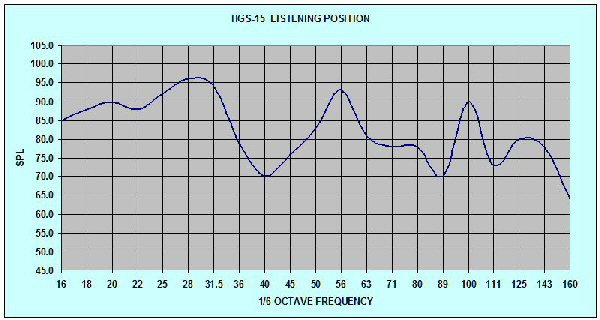

This is actually the pre-BFD response of my sub from my main listening position. Obviously yours may look different… the point is that it will not be nearly as flat as the manufacturers rated response. Our room size, shape, construction, and things we place inside such as cabinets and chairs, as well as the location of our sub, will all have an effect on our sub response. This means what we are hearing from our sub is not what the manufacturer intends for us to hear and it will probably not sound as good as it should. What we can do with the BFD is at least get the response better for the main listening position, and many times it will make it better for those near that main listening position. What we would like to do is get our response to look something like this:
http://www.snapbug.ws/images/subgraph0003.jpg

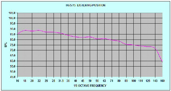

No… this is not a perfectly flat line, it is somewhat of what we call a house curve. This is the post BFD response of my sub from my main listening position. The house curve is what many enthusiasts like for movie watching, while critical music listeners might prefer a flatter response. The house curve is generally flat from 20hz up to about 32-40hz and then gradually falls off -10db out to about 80-100hz (or your crossover point). I don’t know that there is a chiseled in stone rule for the house curve, but in my case it’s the best I could do since I had a nasty dip at 40hz. So… if we take those two graphs, the pre-BFD response and post-BFD response, we can get a really good picture of what the BFD can do:
http://www.snapbug.ws/images/subgraph004.jpg
Wouldn't you agree... everyone needs a BFD!
