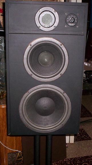

For anyone interested, I picked up a pair of unique speakers today.
Yah I know realistic speakers must be garb right, well that's what I figured
but there design and the price made me grab em ($3 for the pair used of'course)
Well they are a larger then normal 2-way (8" woof 3" tweet) with a 10"
passive radiator and they are also an attempt at being time aligned as the
top portion of the cabinet where the tweeter is mounted is set back about 2".
After taking them apart to inspect, a very intersting xover reveals it'self, the
woofer is run full range (no xover) and all the tweet has is 1 cap! Now if that
isn't a pretty minumal xover then I don't know what is. After checking them
out on the garage setup I see why they have no xover on the woofer as there
is no highs comming from that unit and the mids that are there sound great.
My guess is the 8" driver rolls off naturaly to a point then the tweet takes over.
From the limited testing so far this speaker system has some potential and I
am curious to try these on the 300B with some jazz and acoustical music
(as I do not see them being a loud/big rock speaker).
The extremely limited info I have found for these speakers so far (Optimus-40)
Power Input: 75 Watts Max
Frequency Response: 40 Hz to 20,000 Hz
Sensitivity: 89 dB @ 1 W/m
Wish I could get a phase and impedance chart for them to really try and determine if
weather they fit the mold of a "tube friendly speaker" but the simple xover and decent
sensitivity have me intrigued though, keep yu posted.

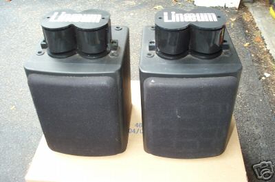

do your tweeters look sort of like figure 8s when you look down on them? i'm starting to think you might have LINNAEUM tweetered speakers. i tried, but couldn't find a pic to verify this.
if so, your speakers actually got a favorable review in either stereophile or the now defunct audio (i think THAT'S where i read the review) about 5 years ago give or take.
if that's the model you have... there's a full review of that speaker in one of those two mags.
the linaeum tweeter is a variation on the piezoelectric drivers often seen in cheaper horn tweeters, but for a minute... linaeums were hot items and there even was a linaeum brand seperate from radio shack.
do your speakers look something like this?
http://cgi.ebay.com/ws/eBayISAPI.dll?ViewItem%26item%3D5800079140
if so, use the word linaeum as a keyword to find more info.

yes.. there they are. those tweeters were supposed to be "the next big thing" for a minute. i guess because they're dipoles which made their image more spacious.
there was a woodgrained model (8" woofer if memory serves me right) that had a front port.
piezo tweeters usually only have caps as crossovers, even with 15" woofer DJ speakers. the woofers operate full range.

No these do not look like those and I will post some pics later. They are
about 2.5 feet tall and about 15" wide with the top recessed back about 2"
where the tweeter sets they have a 10" passive radiator at the bottem then an 8"
woofer above that then a tweeter above that.
Budget my post was not knocking you, just anwering all your questions.
As I build and rebuild speakers not to mention am a service tech also that I allways
take things apart to see how there put together and determine there quality but
put them back together in there original state to see how they perform.
So far these speakers are impressing me. They are wood veneered and take oil.

Yes the tweeter is aprox. 3" round with a cage over it so I can't see what is under
it. There is also a foam ring around the tweeter that is light grey and very dense.
The only driver I pulled so far was the passive radiator as I was guessing that's
what it was. I will pul the other drivers and see if they say anything on them. My guess
would be theses are older radio shack drivers as I don't believe they used others
parts but I could be completely wrong about that.

Here's a pic and I've been listening to these for about a couple hours now.
Impressions so far is that they do voices wonderful both male and female.
Seem to have a little trouble with more complicated/busy passages of music.
Bass is very good, may be a tad rolled off at the top. They seem to like about
10-15 watts of power to really let um shine so yes they do stress the 300B a
little to much. But they do like the 40 watt single ended golden tube audio amp.
Need to play with them some more but what I've heard so far sounds much better
then some other speakers I've picked up recently not to mention others in the past.
Rolled off at the top may be giving the wrong impression as they don't really roll off
but more of they don't extend the frequency range as high as other speakers which
may make them a candidate for a supertweeter to extend there range a bit.

and thrift stores to find things I can repair and rebuild then resell them but I also
find things for myself all the time too and the price I pay is very very low. I paid $3
for this pair of speakers that looked intriguing to me, so to check them out I put
them through some of the gear I have to evaluate them. I would think many people
would envy the gear I have and the ability to evaluate something in a way that others
can not. When most buy something they have to hope it will work with there setup
even after all the research someone has done it's still trial and error that it works
as well as someone may think it will. Trying something in the store for a few hours
is very different then the home envirionment let alone to try it with many other pieces
to see where they work there best or even the quality of the gear.
So yes I have no problem picking something up that may be suspect if I get it cheap
and it looks to have potential so I can bring it home to evaluate it further for both it's
build quality and sonics comparred to many other pieces. (real world eval)
With the amount of gear I've worked on and used, the amount of info and knowlage I've
gained is unmeasurable and I for one feel very fortunate for this. Yes audio is a hobby
for me that I love so the more gear I get to use the better!

KEGGER
It’s an interesting design is that a 12inc Bass LF driver with an 8inc Bass Mid and 2inc HF.
It’s hard to tell by the picture, but I’m sure I’m close?
Username: Kegger
Warren, MICHIGAN
Post Number: 2650
Registered: Dec-03
Andy If you go to the first post it gives all the speaker sizes.
A very interesting speaker with great midrange and bass.
