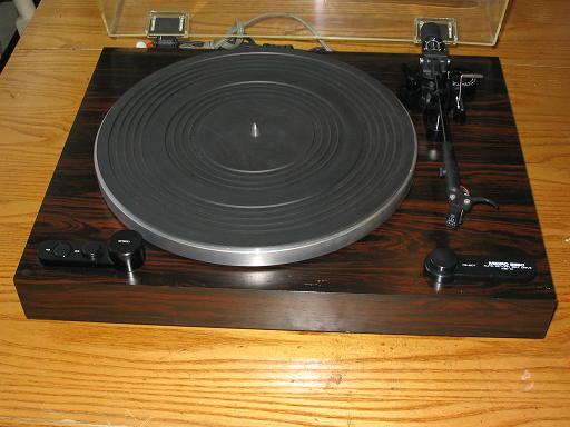

For the Japanese tables in their price range, the Denon tables were among the best. Their looks alone are enough to sell the table. They have a susceptibility to feed back and foot fall problems so isolation is key to getting the most out of the Denon tables. Since you like bass, Sorbothane feet might be a starting point or the new Vibrapod cones: http://www.vibrapod.com/
Placed on a triple layer of MDF, these footers should provide good isolation from most outside forces. Ignore the Denon feet. Do not sit the table on a massive support. Light but rigid is most often best here. Decouple the shelves if possible.
The arm shown in your picture looks like the standard Denon arm for the 62. Does the straight arm have any other identification? The AT cartridge may be a house cartridge for some store chain. You can begin to figure out what it might be close to in the regular AT line by looking at the color of the stylus assembly. The color is almost always the guide with AT.
The 103 should have some identification on the bottom of the cartridge. I don't remember the identifiers on the Denon cartridges, but that one web site probably can help you there. I don't remember the term "double construction cantilever" with Denon. Often this refers to a stepped cantilever that is made from two materials to cut resonance and stiffen the cantilever. If the cantilever has a stepped, two piece appearance, this is probably what the term refers to.

Jan again thanks for the info:
When I setup the table in the "listening room" I will do as you say!
"They have a susceptibility to feed back and foot fall problems so isolation is key to getting the most out of the Denon tables. Since you like bass, Sorbothane feet might be a starting point or the new Vibrapod cones: http://www.vibrapod.com/
Placed on a triple layer of MDF, these footers should provide good isolation from most outside forces. Ignore the Denon feet. Do not sit the table on a massive support. Light but rigid is most often best here. Decouple the shelves if possible. "
All the straight arm says is (laminated damped shell) and denon on it.
Both the denon and that AT look like the cartridges on that website.
The AT looks like this one but the round things on the sides are black!
http://www.audiocubes2.com/brand/Audio-Technica/product/Audio-Technica_AT-150MLX __VM_Type_Stereo_Cartridge.html
And the denon looks just like this one and only says DL-103 on it anywhere.
I have the box and 2 pieces of paperwork for it.
The info is the same also except I don't see this
"Needle: 16.5 micron round pin" listed on my paperwork.
And theres a measured piece of paper in the box from like a factory testing that says .37mv and a frequency graph.
http://www.audiocubes2.com/brand/Denon/product/Denon_DL-103_Moving_Coil_Cartridg e.html

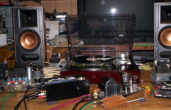

Hey I'm gettin somewhere! Put the straight arm back on with the AT cartridge
which is a high gain cartridge and plugged the table into my pas 3 that I got
running a while back well low and behold it's startin to sound pretty dann good!
Still would like to get a phono stage though, the ear 834p does look interesting
and the gentlemen I got the table from has 1 I can try so I think I'll do that
and test both cartridges on it, would be nice to be able to use both with 1 stage.

Well I picked up the ear 834P it's the loaded one minus the crome faceplate.
Just like this one!
http://cls.audiogon.com/cgi-bin/cls.pl?preaphon&1117703581
He says if I like it we may be able to work something out!
I think the design of this thing is very intuitive.
It has the transformer for uping the mc then tubes for the rest of the gain (adjustable)
stage and when in the mm position only uses the tubes so basicly a 2 in one unit.
And like you said frank it gets incredable reviews.
So I hope this works as advertized!
The owner said the only thing he's heard better is his rhea phono stage.
http://www.musicalsurroundings.com/saturnpg2.html
But then again at $4000 and all the adjustments that thing has not to mention
the quality components it's built with I hope it does sound better.
What a piece of machinary that thing is. Hes got 3 tables hooked to it and
multiple saved settings for each one.
But he swares the EAR was hard to beat and at first before he changed tubes
in the rhea the ear sounded better with that one tweaked with nos tubes also.
So I hope I got a treat coming my way. Well see!
If anything else I'm getting to test a lot of gear in my home which is nice.
He also loaned me his fidelity researh rtf-5 to try.
with all this stuff plus the linn preamp, I'm able to try many different combos.
I just hope it's all worth it in the end and I can find something that works.

Here's a pic of the setup I'm listening to at the moment before it goes to the big room.

Heh, Kegger,
Vinyl can sound a lot better than CD - or a lot worse if setup incorrectly or with poorly matched components. When it's good, it's really really good. My own phono stage is made by a loon in Wales called Tom Evans. The Groove retails for around $3500, has only one input, has no configurability (all done on a back-to-factory basis) and no valves. It's stunning. The problem I have now is simple - it now has a big brother retailing for about $6500 and which I've heard...

Anyways I picked up a micro seiki TT with an older Grado green cartridge on it.
In good shape both cartridge and table, very cheap!
The Grado seamed dull and sloppy on the seiki but I thought the Denon sounded a little
bright and thin at times so I put the Grado on the Denon table. First impressions
quite nice, the combo is sweet and full bodied with great texture but still all the
detail! And no more brightness! Then I decided to put the Denon cartridge on the seiki!
Well that combo is now very good also! I figured at least 90% of the TT sound came from
the cartridge, it looks like I'm finding something other then that though.
More later if anyones interested!
By the way this is still a learning process for me and things may change as I go!
Pic of the table!
