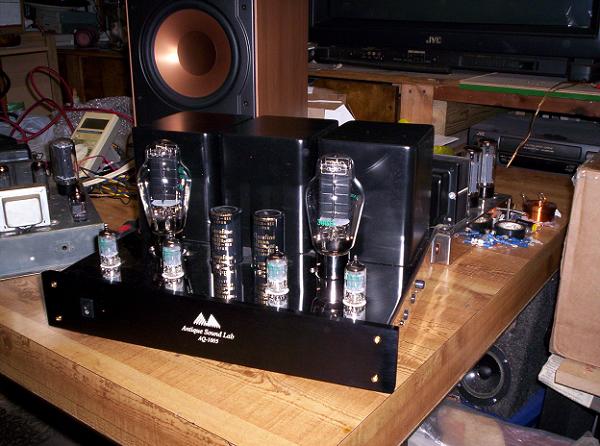

Well I'm still going crazy with gathering amps! Sheez the madness! I picked up an antique sound labs av20 mono block for my center channel. Brand new for $150 plus $40 shipping. 20 watt amp with 2 6l6/5881's output tubes and a 12at7 driver tube with manual bias setting. Seems pretty nice. Then I won an auction for a mono block (H-AO-39) from a Hammond A100 organ. Runs 2 el84's and a 12ax7 driver tube, cheap. Then by next week wednesday I may be the owner of an antique sound labs 300b amp with a 300b per side and 4 12au7 driver tubes for a wopping 8watts a channel. The guy is local and we should be able to work a trade of appox $500 value and $500 cash. This guy seems pretty cool , he suposably knows the guys who started and run audiogon. "maybe not a bad contact" He's a big vinyl sellar! http://cls.audiogon.com/cgi-bin/cls.pl?ampstube&1111622703 |

Two Cents : The ASL Hurricanes are definatly impressive and I wouldn't mind seeing my friend get a pair of those but he's got a price point in mind and the used price of the rogue 150's is a lot more attractive one must admit! Good to see more getting into the tubeness. I hope yours turns out nice. Saw a primaluna prologue "1" I believe on audiogon a while back in my area. They've gotten pretty good press , hope they live up to it for you and I believe John A would be interested in your findings also, make sure you let us know! |

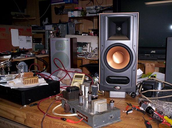

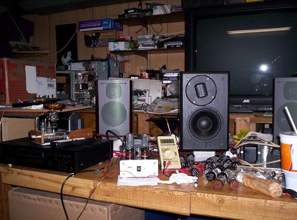

A little tube changing and voltage adjusting!

Well I got my mono el84 based amp at 12watts from ups today. She seems to work fine and the guy says he has a second which I'll pick up. So that will be a pair of 12watt el84 monos for $100 shipped. Not to bad!

Kegman, Congrats! The only question is what socket do the Fig Newtons plug into??????????LOL! |

Well My match to the el84 mono is on it's way. And now for the grand prize! Just brought er home today and were hookin er up!
That completes the collection! "for now" I think it covers most bases! LOL |
Gold Member Username: Kegger
MICHIGAN
Post Number: 2255 Registered: Dec-03
| Posted on Wednesday, March 02, 2005 - 11:43 pm: |
Now well See what 8watt 300B is all about! |

Kegman, I will look forward to your thoughts on the sound of the ASL-SET amp. |

On the picture: u guys r very unorganized.... |
