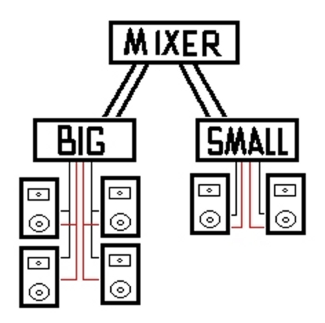

Username: Cheapskate
Post Number: 118
Registered: Mar-04
no.
i'm saying connect two speakers "normally" to each channel of your big amp and 1 speaker per channel on your small amp.
2+2=4
if words don't work, i drew a quick but sloppy diagram with paint. you should get the idea from that if nothing else.
1+1=2
and that comes to 6
i'm suggesting you run all of your speakers FULL RANGE. no high and low biamping. they sound like speakers that already have crossovers.
i'll try to describe it this way:
BIG AMP:
left = 2 speakers
right = 2 speakers
SMALL AMP
left = 1 speaker
right = 1 speaker
no crossover. no highs vs. lows
it would be tough to biamp your speakers as you have an odd number per side.... 3 left, 3 right. if you wanted to biamp, i'd suggest dropping a pair of speakers.
just run them all full range. 4 on the big amp and 2 on the small one. that is the easiest way to do it.
if words won't explain it, i created a quick diagram with paint. (i had to reconnect two times to post it as the first bitmap wouldn't go through)
Post Number: 120
Registered: Mar-04
by the way... "big" and "small" are your amplifiers and their power differences, NOT bass and treble. all speakers are full range.
the big amp will be driving 4 ohms while the small one drives 8 ohms if you set up this way.
all of the speakers should be fairly close in volume level with this setup. just make sure that you position the two "small amp" speakers directly across from each other (or left/right) when you set up or you could have left to right volume changes if the 4 big amp speakers are louder or quieter than the small amp pair.
Post Number: 122
Registered: Mar-04
then just put the crossover in front of your small amp and replace your 3rd pair of spakers with your subs.
your 4 main speakers will still need approximately 2X the power of your subs and your sound will be pretty closely matched. you can then tune your system by raising your subs crossover frequency until your system starts to sound boomy. once it does, lower your crossover frequency and or the power to your subs.
still run your 4 main speakers full range... then you can use the bass in your mains along with your subs.
4 mains and 2 subs is an easier system to setup... just put your mains in the corners of the dance floor and your subs wherever there's the most room.
