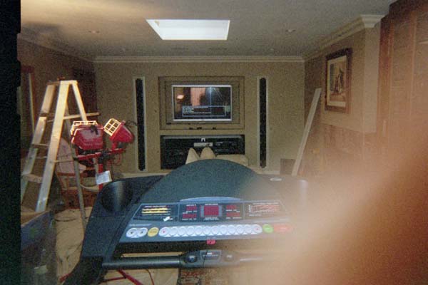

with some power. 200 per side. Both the 4's and 6's are bi ampable but only the 6's have to be bi amped. If you can (afford it), then you should bi amp the 4's. Everthing sounds so much better bi amped. Anyway, the pics I will send are using a speakerCraft DBB12100, and there are 100 watts going to each of the 4 starlet channels. BUT, they are power hungry, and 400 watts is not enough. They also need to be calibrated. The channels do not take the same power and must be powered with an amp that has individual line level controls. for So I have a pair of 9's biamped with aragon at 250
per channel and they are Insane. Leave your email address and I can forward you some pics of installations with the 4's and 9's. My Company is at http://www.soundresearchlabs.com or you could e-mail me at the address posted on the website.
