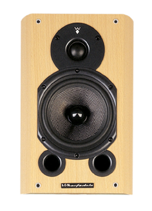

Theres a definate decision I'm getting the Wharfedale Diamond 9.1s, it's just finding a suitable amplifier.
I like the Cambridge Audio A5 which outputs 60 watts per channel but I'm not sure if it'd be any good for the diamonds. Ive got feedback that the diamonds are 100 watt per speaker not 50 watt each in the pair, so I dont want any clipping etc when using the A5 amp. I like the A5 simply because it's £120 and that's pretty much my budget.
Would you say the A5 is a good match for the 6ohm diamonds?
Upload The A5, outputs 60watts per channel at unknown ohm rating, allowing 120 watts of power to bedroom?
UploadIll have 2 of these, I guess with the potential of 100 watts each, not 50watts each?
Please, just anyone cool, give me advice and help lol...

I know the Diamonds and they're very easy to drive. You should not have a problem with that amp. Don't forget that the rated 'power' of a speaker is actually the maximum power they're rated to be able to take. That said, a more powerful amplifier will simply grip them better. It won't clip but, after suitable abuse, it will blow the speaker. If you use a weedy amp, then again after suitable abuse the amp will start to struggle, clip and either give up or break the speaker due to the distortion it'll be feeding it.
By the way - the Diamond 9.1s are an excellent buy. Probably the best speaker in the curent Diamond range.

Agree with Frank, the 9.1's are excellent bookshelf speakers. With a good powered subwoofer, the Audio A5 would drive the 9.1's beautifully without you worrying about distortion and clipping even at high volume. Considering the fact that the 9.1's has 5" midbass drivers, you'll need a subwoofer anyway. My 2 cents. :-)

Actually, my point is having the sub to share the low frequency load will make the A5 sound much cleaner and because the A5 won't have to handle the low bass, which requires lots of power, you'll not need to worry much about clipping. Also, without a sub, the 5" drivers will easily get damaged when you play rich-bass music. You can buy a subwoofer later when you can afford 1.
