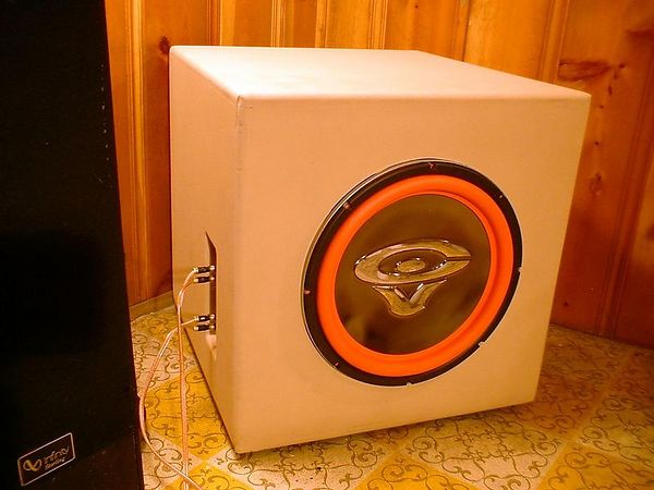

Hey Slade, in the words of Tony Montanya "Say hellow to my leetle fren"
That there is a Cerwin Vega V-Max 15-DVC. Yep, a "car" sub. Only if you run the specs, it models out to be a very good home sub.
Misconception #1. Car subs don't play deep in home.
This one has an f3 @ 25.5Hz. That's even before adding room gain. Theatrical lows anyone?
Misconception #2. Car subs are boomy.
This one has a system "Q" of .68. Nice and tight. Gotta love a big driver in a big sealed box.
Misconception #3. Big car subs sound "slow".
This one has a max group delay of 10.62ms @ 16.48Hz. Quick enough for 'ya?
This is what I use for HT now (useable output below 20hz). The twin Solo's are still in use (for music) as they have more punch in the 30-40Hz range.
Don't get me wrong. Not all car subs are suitable for home use, but my V-MAX and my Solo's are.
